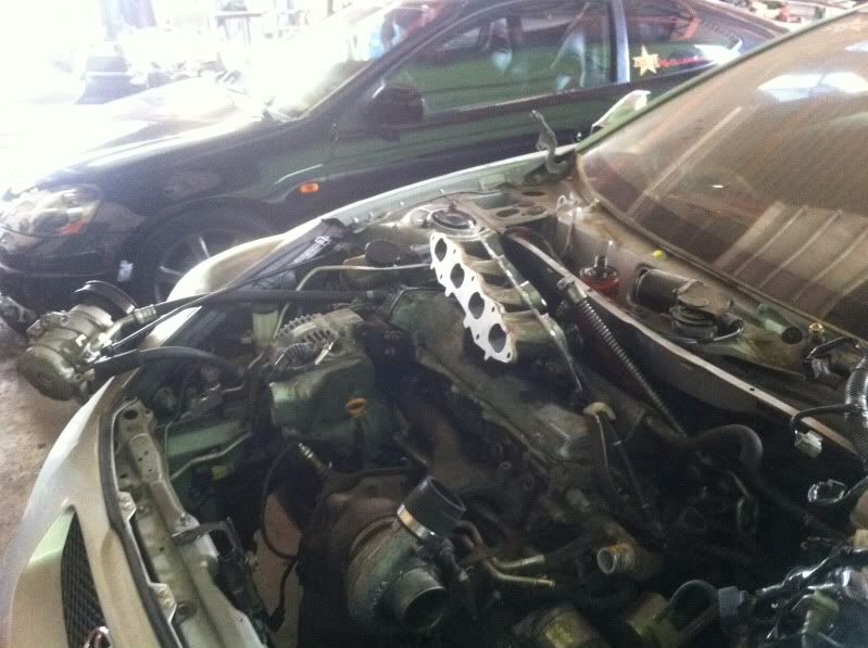

This is a project I have been thinking about for a few years, ya know take the bitch out of my 7th gen GTS...
I got a 3SGTE/Wiring harness/ECU/etc... about 6+ months ago and have been waiting for time.
I got some time this week and we got it hung so far! Axles are super straight! Making front and rear mounts next week and I am going to need a SMIM (Sheet Metal Intake manifold).
There is some space issues with the cowl and the long intake manifold that came with my 4th gen 3SGTE.
I could hack up the cowl and make it fit then fab somthing for the windshield wipers OR I could leave the cowl alone and make a SMIM to fit and the SMIM will make more power... No brainer there! SMIM it is!
This is not one of those 'Can I do It threads'
I am doing it and just going to fill ya'all in...
There will be more to come next week!
Not a great pic but that is a Caldina 3SGTE (Coil Pack Motor) sitting back with that S Engine Family Gangsta Lean.
My goal is to keep everything functioning like stock, AC, Gauges ETC...
BTW, the 3S motor fits pretty great so far... maybe there is something I have not run into yet that is the reason everyone acts like it is impossible. I cant believe no one makes a kit...
After i get this running in FWD mode I am buy the rear subframe assembly from a GT4 and going to explore the possibilitys!

what about a BEAMS style intake?

Also, it looks like you could angle the engine up a little straighter to get more room back there maybe.

It is in and it fits really well! Like it was suppose to be there...
We were able to use all the 7th gen body portion of the mounts. new engine/trans mounts were fabricated. I like the fact that all the factory vibration isolators (NVH) are still in use.
After discussing, I am going to use the 3SGTE AC Compressor and have new lines made. It seems easier than using the 2ZZ AC Compressor. I am also going to use the 3SGTE PS pump, should be simple.
Still unsure of shift cables, will update that later.
I have the axles all sorted, they are being made.
The fabricator sketched me the intake manifold he has in mind and it looks sweet! Short and fat! He said a week plus on it though
Fabbing a 3" exhaust, I have a trick up my sleeve for that and am hopping it ends up REALLY quiet.
Fabbing IC piping for the FMIC.
I am sure there is alot more I am forgeting right now, oh yha, like the fuel system problem (returnless in the 7th gen)
This rear mount was the most detailed for fabrication
I will have many more updates

Got a little update, SMIM (sheet metal intake manifold) construction is slowly in progress!
Cut the base of the stock Caldina intake manifold, using it for a flange and base.
Started to shape the runners, Short runners with a big plenum is the goal.
There is really not alot of room left behind the motor in the 7th gen.
I snapped a couple pics of the progress so far...
Quote:
Originally Posted by mrfunny107 View Post
You know what would be funny... If this was all just a really really elaborate game of photoshop. But still this is pretty cool. U should have just gone all out and do AWD too.
I thought of you today so threw the start of this SMIM on the motor and snapped a pic;
Photoshop that!

SMIM is almost done!
Need a TB plate and provisions for all the stock sensors!
It is installed from the bottom, like I said not alot of space there but it fits nicely and will work pretty well with some cams and more airflow in the future.
This design may evolve in the future.
