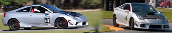

Originally Posted by Toxygene View Post
That's nice but it doesn't show the offset for his TSW wheels. Plus there still aren't any clearance shots for behind the wheel.
you kidding right? look at these shots, about as perfect angles too see how they sit flush to the fenders
now im not saying brad dosent know what hes running but on tsw site they dot list the 19x9 tsw site
another reason why i think they are 8" wide not 9" is because a 235 tire that hes running will look stretched on a 9", and his tires arent stretched, but its best to ask brad to be 100% sure
i think a 9" will be ok in the front, but will maybe just maybe rub on the rear lower arm
this is the one im talking about that may be rubbed the the 9" with a +35

I love the shots of his fender to wheel gaps. I saw those on the link posted. I really wanted to see that shot of the wheel to suspension clearance in the front. I'm surprised there was an issue with clearance in the rear as in this thread there is someone who ran a wider wheel fitment in the rear with only fender rolling as the only requirement.
I'll PM Brad and see if he can chime in.
I talked to Brad. He told me his wheels are 19x8 and wasn't sure what is offset was. It looks like it is in the 35 offset range judging by the pictures.

^^ 225/40 is what 90% of us with 18s run .......................... i ran 245/35 before and i didnt like it ................ and no s.techs with 18s shouldnt have issues
and yeah i was pretty sure brads werent 19x9 by how his 235 sat on the wheels
