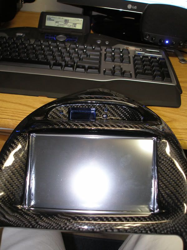

UPDATE:
I eventually covered the opening with a Kenny Heiser carbon fiber Clock face (no longer available) but you can make something similar

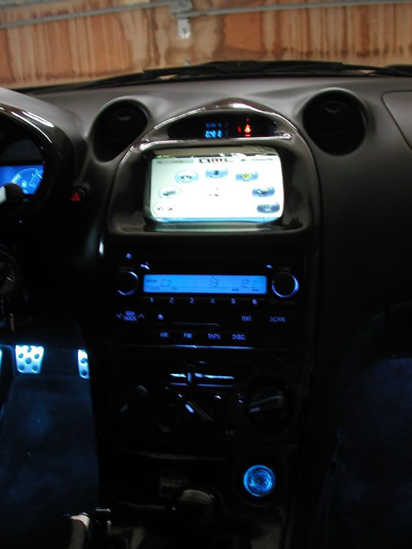

Just did mine looks great during the day!!
All there is to it is that since you take off the outside plastic where it says passenger etc leaves a gap between the clock and the clock mounting.. Apart from that its great!

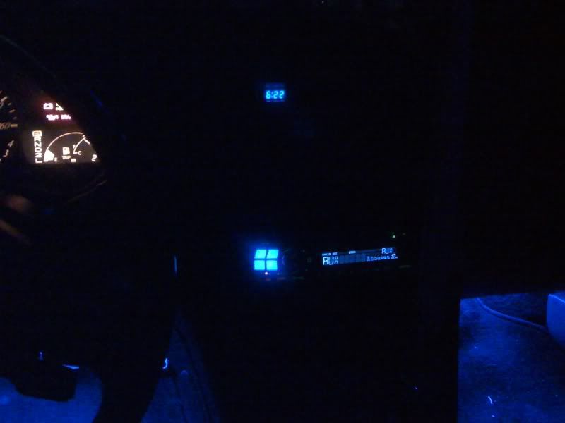

I tried this on my 00 celi. Was aiming for a blue color, and although at night its pretty close to blue its really dim. Durring the day i cannot even see the clock. Yes i cut the dimmer wire. Im thinking the purple celo might be just too purple and its blocking out to much light. If any1 has a better idea let me know, id really like for this mod to work but atm im pretty dissapointed with my result.

hombredelassrta
Join Date: Jul 2004
Location: Palm Beach, Florida
Posts: 14,069
iTrader: (55)
Send a message via AIM to hombredelassrta
the blue sheets i used were not blue enough so i used a blue sharpie ontop of them and it worked better

^^ yup the filter (clear colored binder) was more of an aqua so i used a blue sharpie on it
