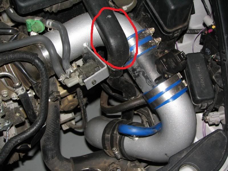

okay i tried installing my Bomz(ebay) intake(FOR THE GT) today and i had a lot of trouble and FAILED
i got the stock airbox off and everything no trouble but when i went to install the actual CAI i ran across numerous problems
the first was ecu tube (?)
that thing circled. thats not my picture just an example, but anyways that was in the way of the CAI tubing, i removed the part circled but the piece it was attached to was in the way
i am wondering if i actually need that because some pictures ive seen do not have that there at all, but in other cases like AEM and INJEN they have special ones to fit around the intake.
secondly, the opening on the intake manifold that you are supposed to close off with a rubber valve seal, i couldnt find it
the pictures i was looking at in the install sections were all for a 2zz, and the 1zz's throttle body is positioned differently and there was no tubing from the intake manifold that i could find
help is much appreciated because i dont want to be doing this for 4 hours again and getting nowhere

It won't cause anything to overheat, but you shouldn't need to remove it. The only reason I can think of is if they didn't give you an angled pipe/coupler for the CAI to be routed underneath. A straight coupler is used on the GT-S, since the throttle body come s out straight from the intake manifold, but the GT's is angled upward. Some kits on eBay have the angled coupler, some don't, so you'd need to check the pictures on each auction. Not sure if they made any with angled piping, though.
183 Posts
ive got the bomz cai. I had the same problem. I have been running the car without the ecu cooling tube for 2 years now no problem. There are heaps of others doing the same thing. Minimal air gets through that thing so its ok.

i had the same problem when installing my injen cai, that black ecu tube was in the way. there is something that mounts it on the bottom that i detached and that made it move more freely.
in regards to where you need to cap off the outlet to your intake manifold it is connected to a really tiny tube. I used a screw to cap it off, but here's a pic of it on a gts. In a GT it is right next to the throttle body.
It's the yellow cap. You'll see it on your engine, don't worry.
