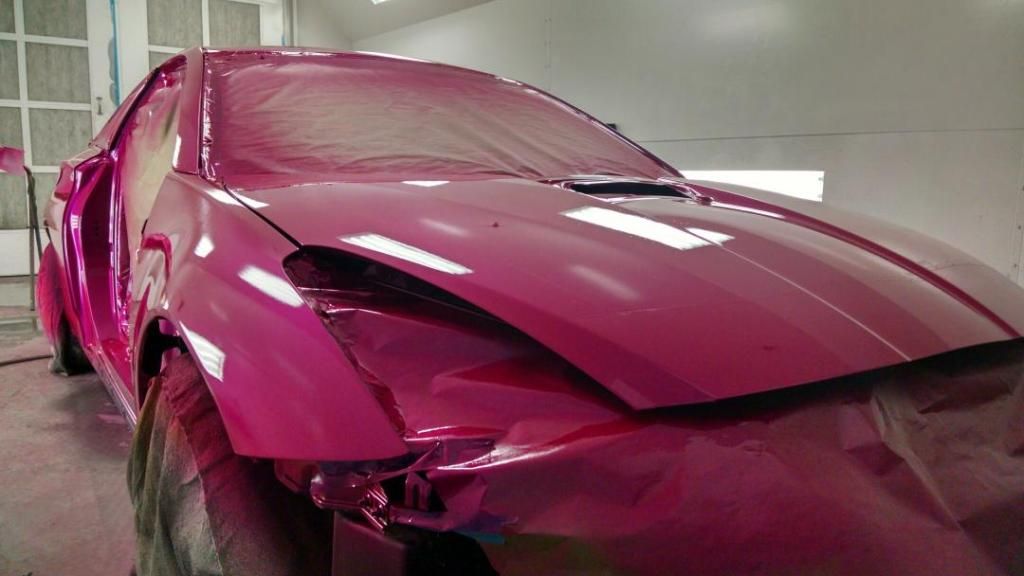

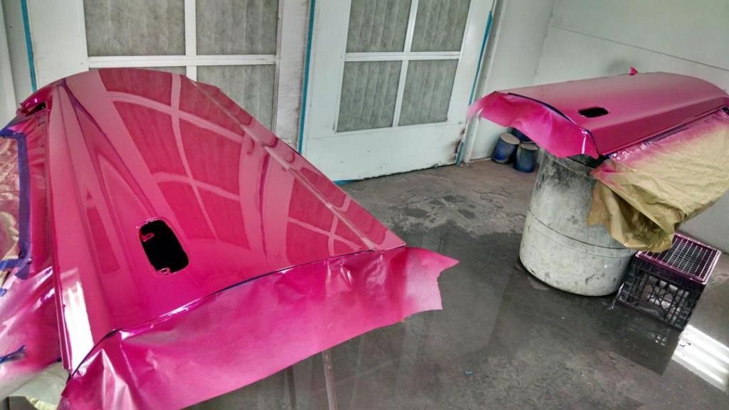

The pictures are rolling in from the paint shop. Urekem Hot Pink Pearl. With SPI universal clear. Painter said the paint is great. He said it's been drawing a lot of attention, and the pearl is awesome. He's painting the rest of the car today and then will buff out the clear Monday.

wow looks great man. looks like a very thorough paint job is in progress :thumbup: i wish i could justify a respray on my car some day...
while the colour may not be to everyones tastes, the important thing is the quality of the job. looks like it's coming along nicely and will be a joy to detail on those hot summer afternoons. urgh, i miss having gloss paint sometimes...

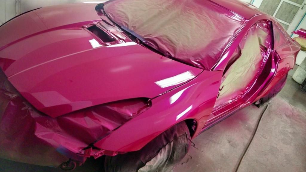

Did you do a flat black, or is it plastidipped? The color is definitely gonna have some haters, but I think it's gonna look bad ass when it's done. Would I ever paint my truck pink? He'll no. Overall, with the black 18s, lowered, tinted black, it should look slick. The painter said it's been getting a ton of attention at his shop. He said it is probably the best paint job he's done. I hope that's true, should be very nice. There is a ton of pearl in the paint, it just shines. Here's a picture of it after the first coat of color:

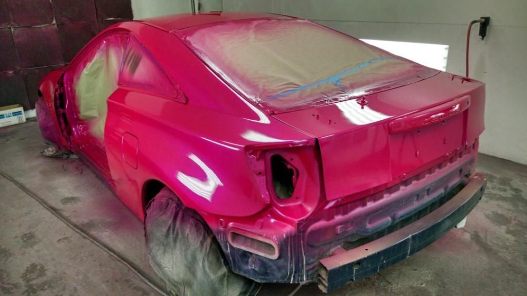

Black accent has a fresh coat of black paint too. You do see some paint on the window. The window had a big crack in it and I touched up the inside of the surround there. New window coming this week. I'll get some more pics this week in the day time after the windows installed.
