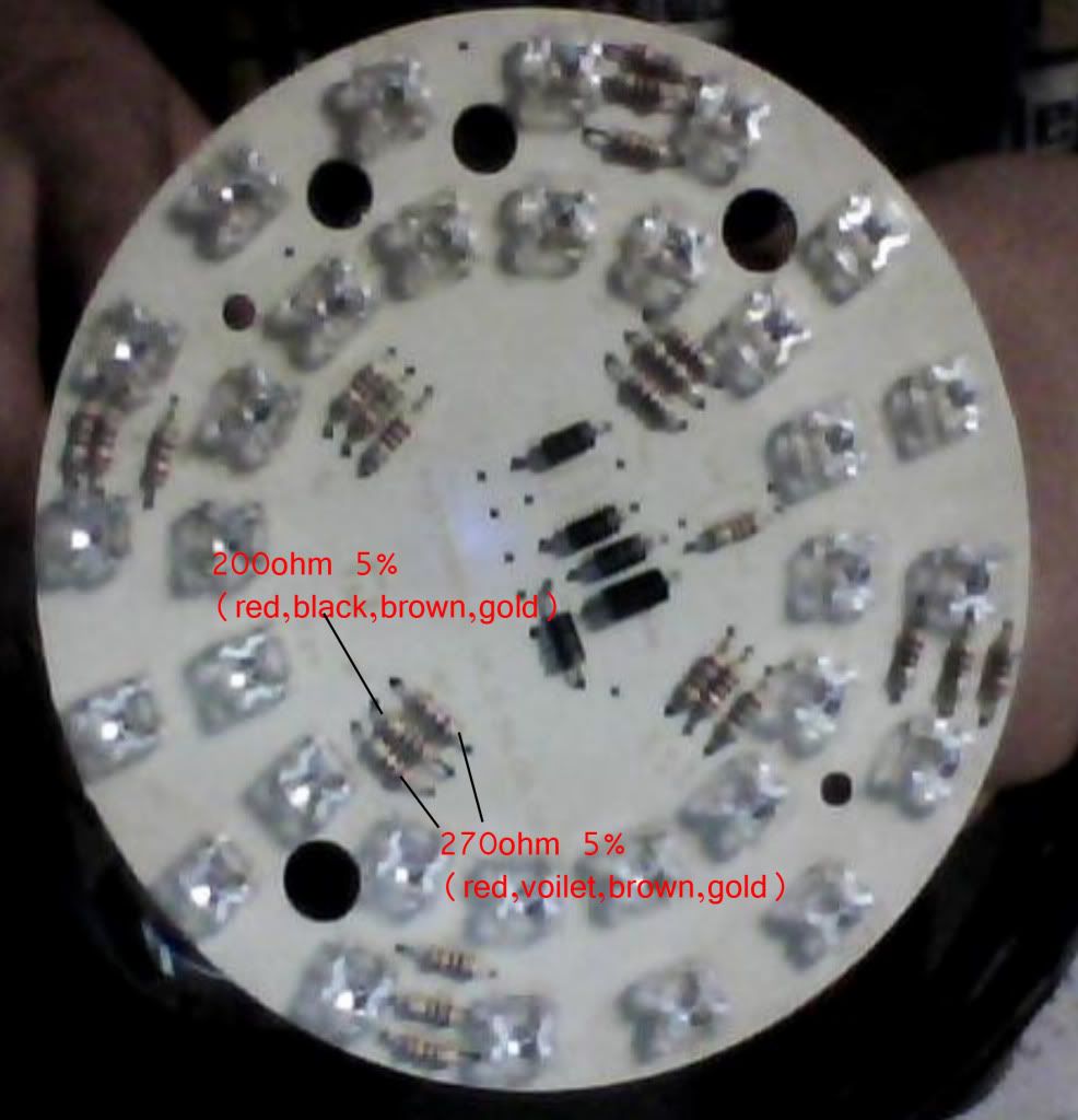

Well i got these led tail lights a few months ago for free so i tried them out and noticed that the indicator is red which in my state/country is illegal so instead of selling them and buying new ones i decided i should just dis-assemble the tail lights and change the led's, so i bought these 3mm yellow piranha led's which fit perfectly in where the old led's were but they will not light up here is a image of the lights
there are resistors currently there but i do not know if i should remove them or change them cause they are 270ohm and 200 ohm resistors but i got 56 ohm resistors with my new leds??
here is a picture of my electrical in the taillight

yea i have check the led's prior to installing them so i know they work they are grouped in fours with the three resistors per each group and i am just changing the resistors now so we'll see if it goes well or not thank you for your help and im pretty sure the 270's need to be changed the only thing i was uncertain about was the 200 in between the two 270's that is what i was asking help for really ill try it and post the results asap

it worked perfectly don't need to change the 200 resistor's though one more question i have a box which is apparently a resistor which slow's the indicator light down so it doesn't flash so fast does anyone know how to make one or should i just contact the company directly??
