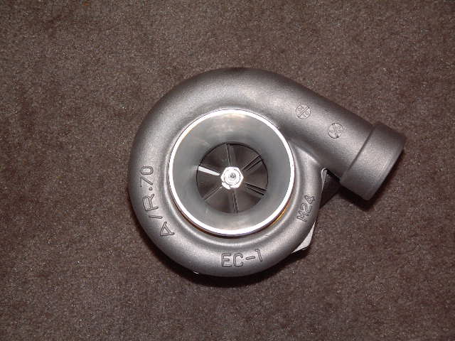

Well after much searching and decision making...i ended up going with the GT35R duel ball bearing...look how much bigger than the super 60 it is...SWEET!!!!

Originally posted by Smaay
im looking for 400 to the wheels or better....and id like to keep the rev limit at about 85-86
What made you chose the GT35R when the GT30R is rated for 350-500 wheel and will spool faster.
I have similar power goals which is why I am probably going to go with the GT30R
because Aaron at ATS racing told me that the 30 will run out of steam at the higher RPM's where as the 35 will still have juice left...and the lag difference between the 2 will be very minimal...im going to use teh same turbo on my 2.2L stroked 3S-GTE in my All-Trac
Hey smaay, what A/R on the turbine side?
read the same thing on the rsx forums

This turbo is huge! I guess even for your 2l conversion and even at higher revs the GT30R should do.
But I'm absolutely excited to see the results. That Turbo is awesome...just too big. ;)
Are you looking for streetable performance, or just a Dyno / Track Queen. I agree with the GT35R for Track / Dyno purposes...but for all around streetable performance (not just straight line performance) I am going to stick with the GT30R.
Nobody gets anything over 400 horse out of a GT30R on a 2.0 L without crazy boost levels. Smaay made the right choice.
I will post Dyno results this Spring that will suggest otherwise. :thumbup:
