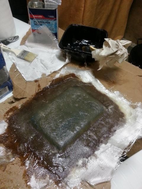

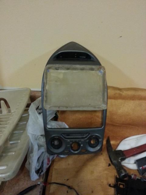

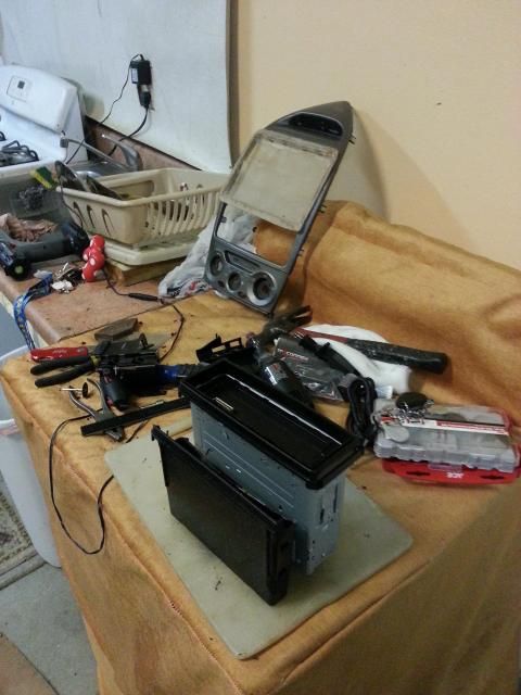

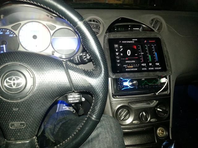

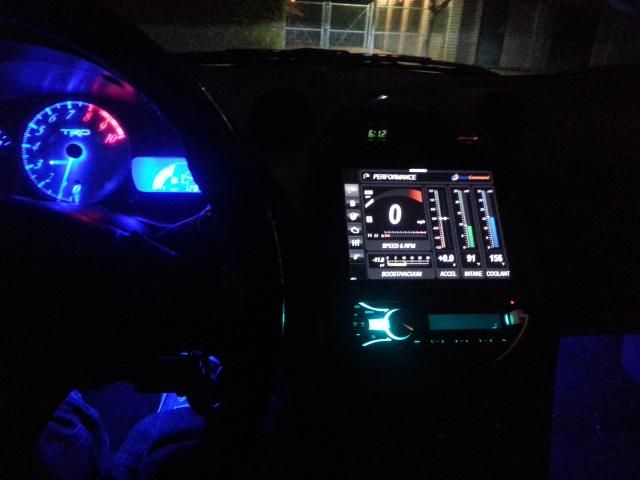

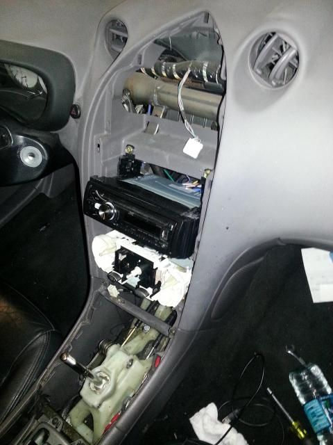

So i made a mount for the ipad mini. Instead of buying soundman $200 mount i ended up making one by myself from scratch.
custom mounts were made to move the stereo lower and cut the cd pocket.
Mini is connected:
stereo: music and videos
obd2: to run dash command
Tethering: Navi
Plan on redoing the suede this week. Why suede to match headliner pillars and other little suede aesthetics in the car

Nice work but the suede doesn't match and there's a gap at the bottom of radio.
Yeah gonna move the mounts lower but theirs these ridges that are in the dash that dont let it go that low. So gotta figure something out as for the suede having second ideas of going a different route.

i definitely would have spend more time on the molding and made all of the edges smooth into the factory piece. that looks a bit sloppy but has the potential to be really nice if there was some more time spent on attention to detail

I agree, this has a lot of potential. However, like others have said, it needs a bit more attention. I can't tell, but some of the pictures make it look like its not completely centered. And make sure the edges and everything line up, just to make it look smooth and that it flows. I would also recommend thinking about wrapping the whole thing in vinyl or something like that, the suede looks kind of out of place.

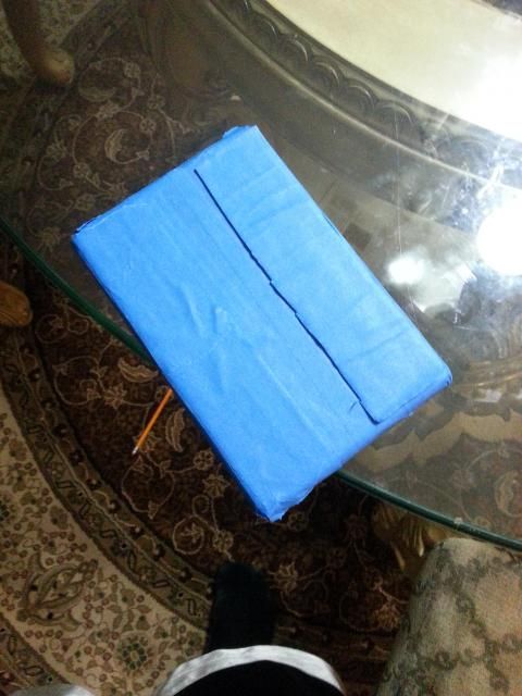

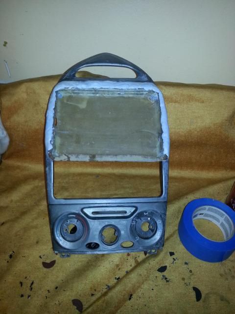

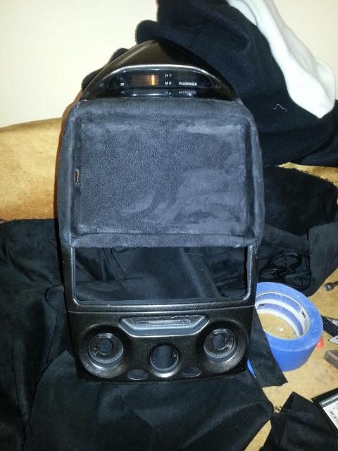

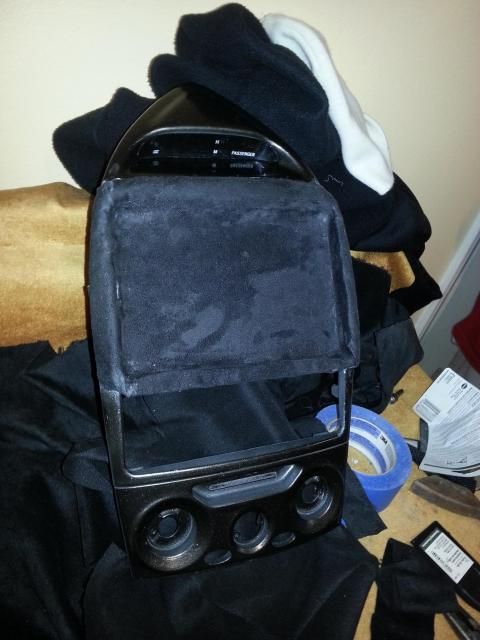

So i redid the ipad dash mount and made it look alot cleaner since i wasnt happy with it.
Its mostly done but a bit to go from sanding down some of the little rough edges and such.
Gave the mini a deeper look so would help with the glare coming from above and the sides. The middle will be suede.

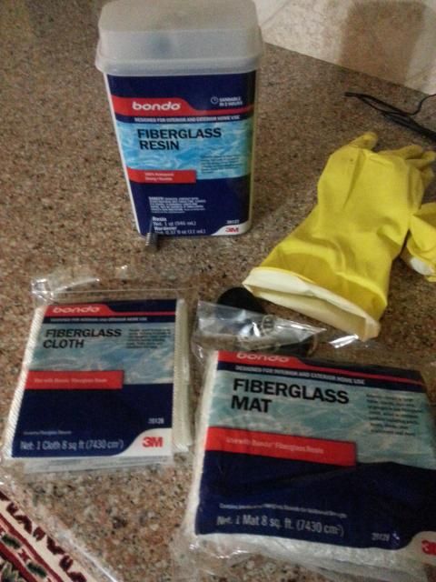

Haha man i didnt have creative skills either but was just learning as i went. Its a fun project as much as a pain in the ass since i never used fiberglass or bondo before. ITs connected by usb i have and turns on as soon as turn on the car and plays what ever was previously playing

And don't need to really be a magician to make this work. Patience is the key as solid glasfibre is a pain to sand down.
