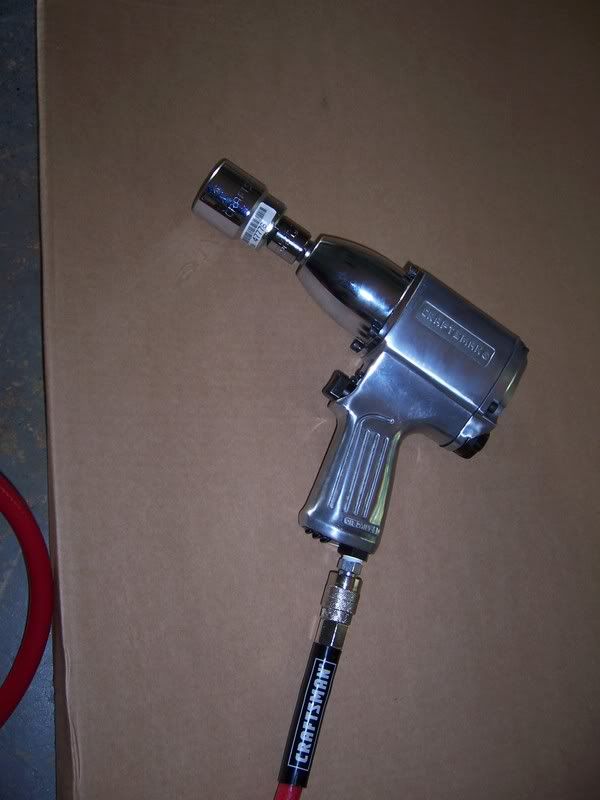

Oh yea $400 later and 10s of work I got the axle nuts off real quick.

Nice buy on the compresser and impact wrench. They will come in handy.
All you needed was a $30 breaker bar with the socket you got. Just pull on the breaker bar while someone steps on the brake pedal. But I'm glad you got it off. Spray PB blast on anything that doesn't want to move. It's about $3.00 at any pepboys, autozone etc. It's a s*it load better the WD40. done go for cheapy axles cause they vibrate. Rebuilt ones are the best cause same warranty, I get it for $49.95 through my garage and it's individually hand built! Need help I'll try to help. if you were in Jersey I would have done it for you.
