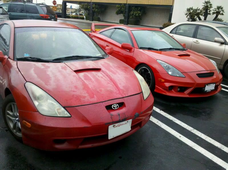

Hi guys, I went to the mall a few weeks back and parked next to this celica..
This thread is not to showoff how my car is shinier than his/her celica but to figure out what this owner has done to his/her car... and in doing so, we could possibly prevent any future damages on our paints.
Any thoughts?

its pretty obvious. most of it could be sun damage. some of it could be salt damage from the beaches. mainly:
1)dont let your car sit out doing nothing.
2) wash it so the dirt/grime, and clear coat does not bake.
3) wax and polish once in awhile.
4) wash it.
the front bumper well....girls cant drive :laugh:

Probably was crashed and poorly painted. Toyota's non metallic colors (as far as I know) do not use clear coat. That car is shedding clear coat.

That graying area is full out clearcoat failure- the clear has delaminated from the color (base) coat. There is no coming back from that and a respray is the only solution. If it was just what is normally called 'oxidation', it could normally be buffed out. Clearcoat failure is the extreme/end case of oxidation.
As for how it happend, ya, it was probably a poor respray job with a cheap clear. The car being dirty, especially from bugs and bird crap, can speed up the process.

Yea, look at older MR-2's and Celicas. The red just fades to powdery pink, which would not be the case if there were clear coat.

best test for clearcoat, rub a spot with some rubbing compound or scratch/swirl remover. If it comes up with your paint color on it, you have no clear coat. If it comes back just a little dirty looking then you have clear coat.

Toyota use to single stage their solid colors but our celicas are base coat/clear coat

Really? First time I polished up my black turd I rubbed off some black paint.
