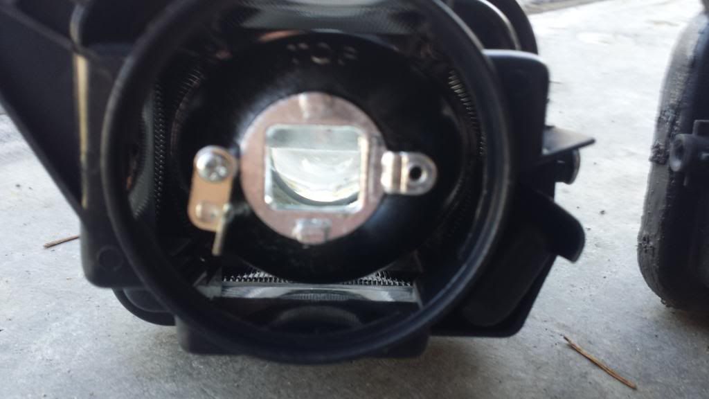

One of my 00-02 fog lights cracked which let water inside and corroded everything inside. Saw these on EBay so I gave them a shot
So in case you're looking to try these out here is a review thread before you buy them (I don't know if they work with 03+)
These fogs DO NOT come with brackets however they do come with all the screws that attach to the bracket aka leveling screws
Disregard the gunk around the glass and the housing I've reopened and sealed mine a few times

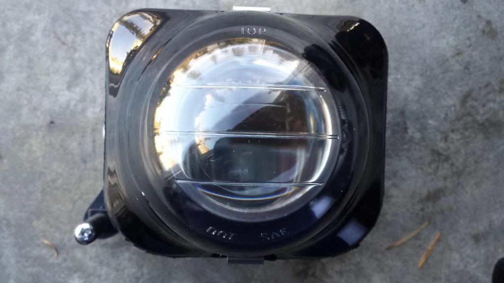

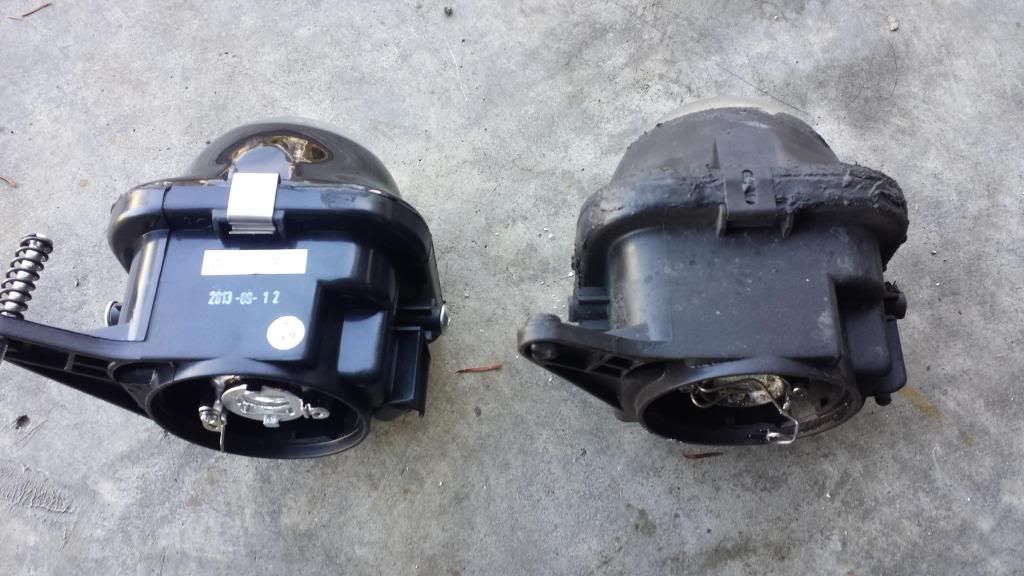

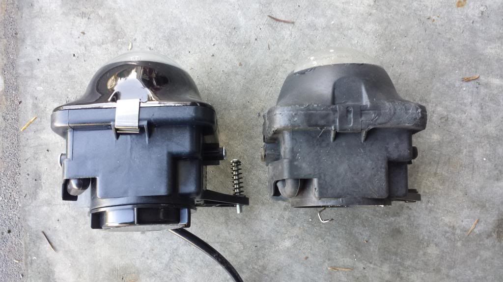

Everything attaches and fits like OEM including the harness, but the back covers are not interchangeable without some shaving
Left - Winjet
Right OEM

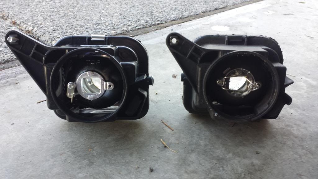

Where the bulb sits in the Winjet are not indented like the OEM one
I have 3k HID bulbs, they do not fit them HID bulbs nicely (Some grinding is required) however they fit regular halogen bulbs just fine
Here is a closer picture

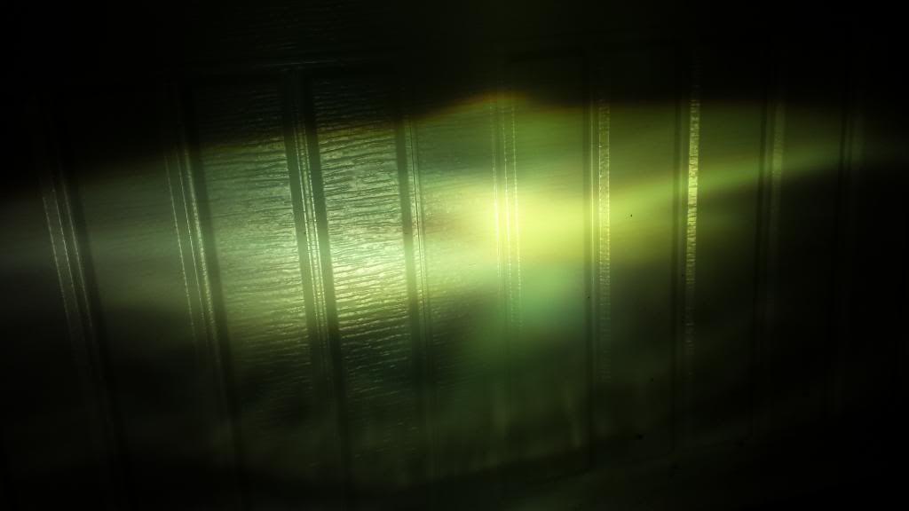

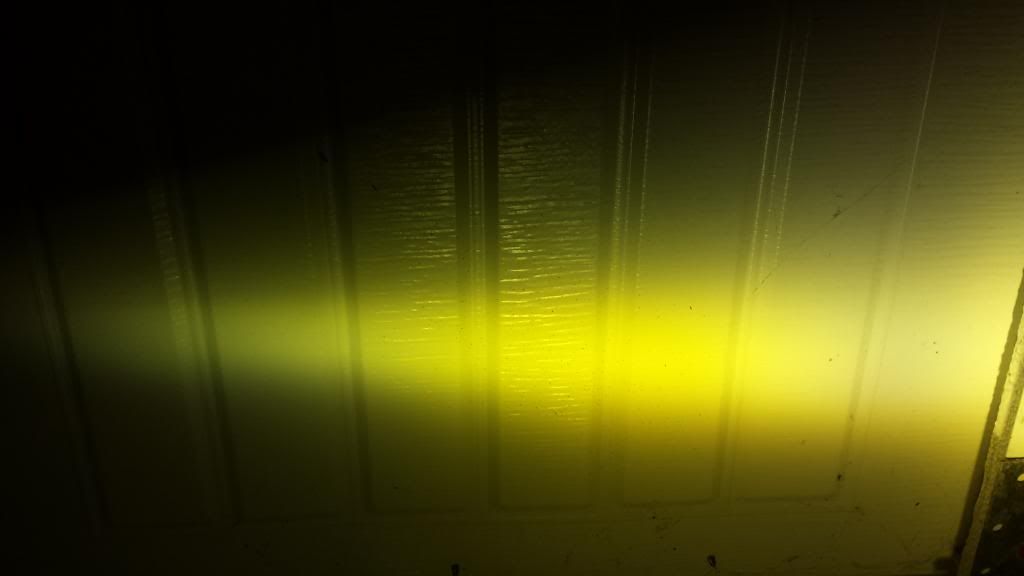

Winjet beam
OEM beam (From my good fog light)
The beam pattern is not nearly as clean as OEM nor is the cut off as clean either
But they were 49 bucks free shipping for a pair:money:

Possibly, I'm not sure if the OEM projectors would fit in the Winjet housing though seeing as there are slight differences

I could see the difference right there from the OEM to non OEM. The lens is smaller, it's clear also.
