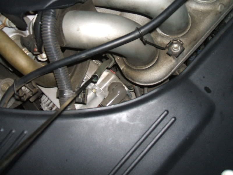

1. First thing to do is open your hood and inspect your oil. you can do this by taking out the dipstick and looking at the end. if the oil is black, its a good thing your changing your oil!
This is where your dipstick is located :
and this is what it looks like when its taken almost out

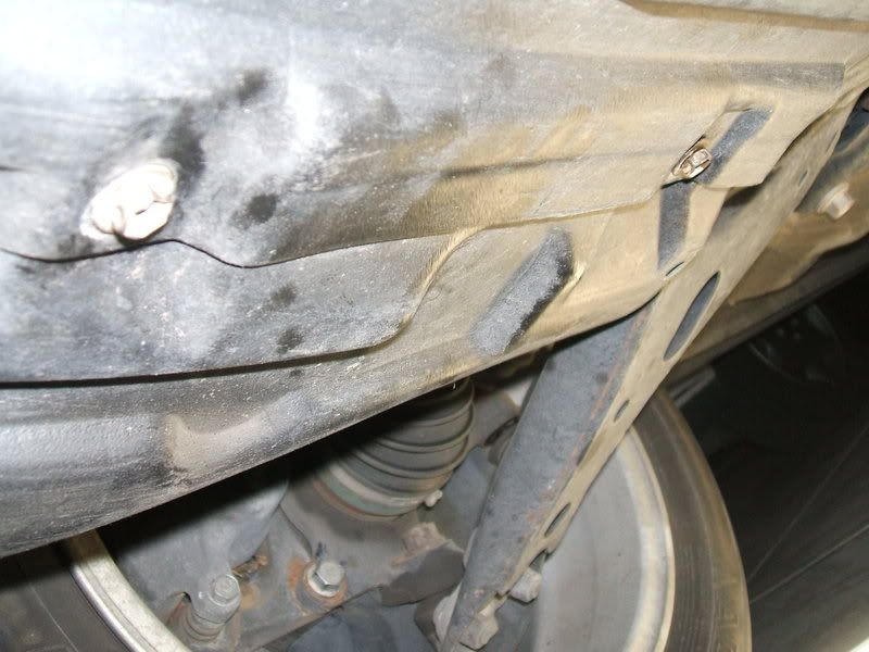

4. Now that your car is up and secure you have to take off the plastic cover . it usually has 2 screws and one plastic locking thing.
These are the two metal screws, you can use a philips screwdriver to open them... or use a 12mm socket.
and this is the plastic locking thing next to the two frame bolts. ( do not unscrew the frame bolts. just take off the plastic one)
This is the plastic cover once its taken off:

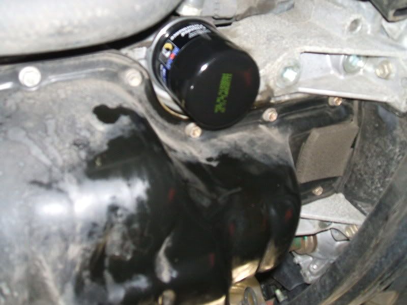

5. Now you are able to see your oil filter and oil drain plug.
and your oil filter is on the opposite side of your oil pan.

9. Move the oil drain pan under the oil filter.. Secure the oil filter cap wrench to your oil filter and use your ratchet and plug it in the oil filter cap wrench and slowly remove the oil filter. The filter oil should be leaking out now. and let it drain completely.
10. Take out your new oil filter and open one quart of oil. Apply a very thin layer of your new oil to the rubber gasket on the oil filter.
11. Tighten your new oil filter with the tools you used to take your old one off. It should be hand tightened and then with the tools tighten it just slightly more.

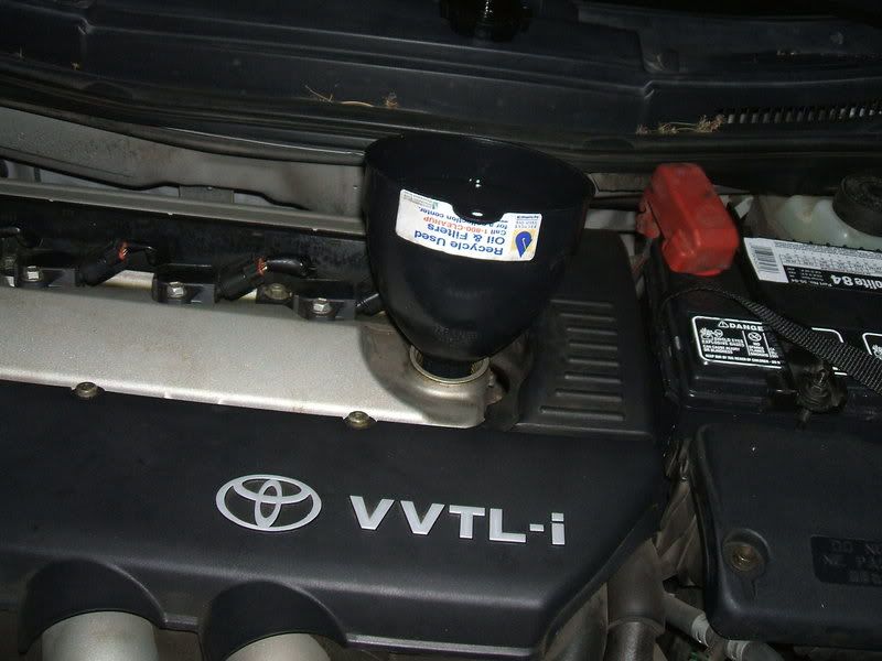

12. Crawl out from under your car and open the hood again. Remove the oil cap and make sure your funnel is clean. When your funnel is clean put the tip of the funnel in engine.
13. Add one quart at a time and monitor your dipstick to see what level your oil is at.
14. Keep adding a quart until its at the appropriate level on your dipstick... remember to wait alitle for the oil to settle to make sure the oil level on the dipstick is accurate.
15. When the oil is all set and the correct level of oil is shown on the dipstick, Close the oil cap and make sure your dipstick is inside the metal hole and let the car sit for a minute or two to absorb the oil and start the car.
Those should be 10mm;)
You don't have to take the plastic undercover completely off. You can leave on the last rear plastic clip, closest to the passenger wheel, and just swing the panel under the tire & out of the way. Makes it easier to put back and line up.

Hmmmm, my manual GT-S doesn't have that plastic cover. It has it under the tranny on the drivers side tho. Maybe previous owner took it out and left it out for ease of acces. I don't think not having the one on the passenger side will damage something, right?

I think the plastic thing is to stop the oil from getting on the floor if it was leaking.
That's what the Tampax pad on the bottom of the panel is for. The panel itself is for aerodynamics, splash protection, and directing the airflow from the hood scoop.
Fill the oil filter about 1/2 way full of oil (for startup).
Don't press the funnel down on the baffle in the fill hole.
